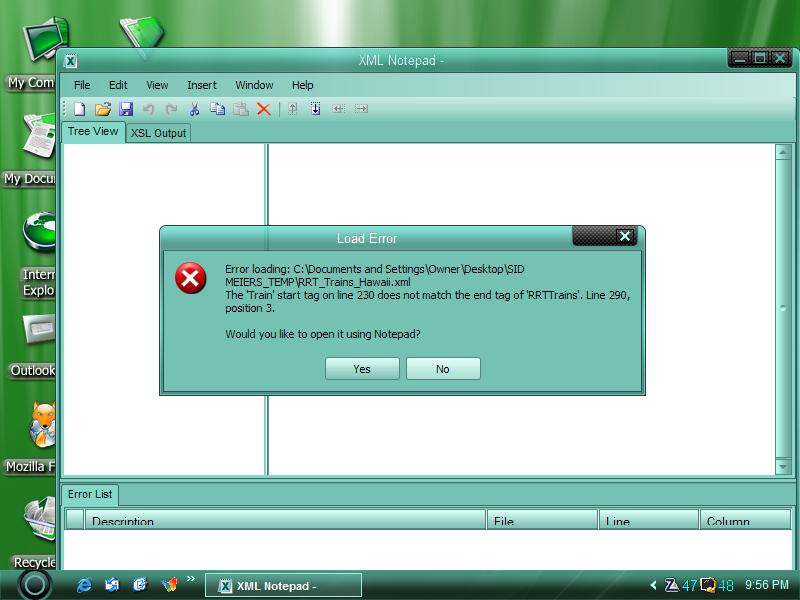

I never got into the global XML"s Just trying to changr the one RRT_Trains_Map_XML to make my all trains. I was having to many problems even after adding tenders to the TrainCars XML. I finaly got some added and working but have an error in it. I have looked at this for ever and don't see it.
Maybe you will see it. BTW this is what I use now for the all train XML.
I found some errors in the zip file, after fixing it now the new engines don't show up.
