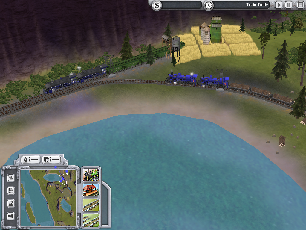

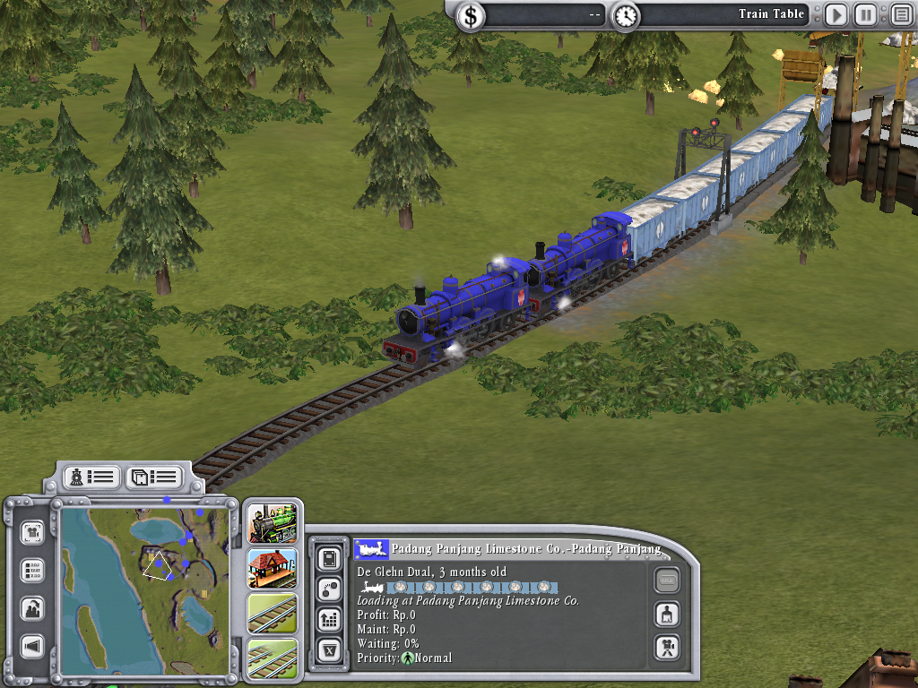

Bushdoctor wrote:Hmm. I didn't get to test the Mikado Dual yet
because other problems popped up with the De Glehn Dual.
Firstly, the engine does not visually appear as a dual locomotive.
It appears as a regular single loc, but with the power etc of a dual.
Secondly, the Dual Glehn does not want to accept any other car than Passengers.
Which is strange because the prefered cargo for that dual loc reads Mixed.
The single Glehn accepts any car but has Passengers as prefered cargo.
I've got a feeling that these Prefered Cargo designations are being determined
by the speed or power of a train. I haven't found an entry refering to this.
Any idea why my Dual Glehn only wants to accept Passenger cars?
Here's the xml entry:
<szName>TAG_NAME_DE_GLEHN_DUAL</szName>
<Year>1911</Year>
<szManufacturerName>De Glehn</szManufacturerName>
<szModel>4_4_2_deGlehnAtlantic.kfm</szModel>
<szDummyModel>4_4_2_deGlehnAtlantic_dummies.nif</szDummyModel>
<szCar>_v1</szCar>
<szNewTrainImage>event_newtrain_4_4_0_deGlehn.dds</szNewTrainImage>
<MaxSpeed>9</MaxSpeed>
<Speed0>9</Speed0>
<Power>16</Power>
<Cost>340000</Cost>
<MaintenanceCost>10000</MaintenanceCost>
<Diesel>0</Diesel>
<RunLength>88</RunLength>
<HasEngineer>1</HasEngineer>
<rgbDefaultColor>230,0,0</rgbDefaultColor>
<iPitchChange>4000</iPitchChange>
<szTenderCar>DeGlehnDummy</szTenderCar>
<BitmapIcon>
<szFile>Assets/Interface/TrainRouting/routing_deGlehnAtlantic.tga</szFile>
</BitmapIcon>
<SpeedSounds>
<szSpeed>AS3D_TR_STEAM_ENGINE_SLOW_LP_1</szSpeed>
<szSpeed>AS3D_TR_STEAM_ENGINE_MID_SLOW_LP_1</szSpeed>
<szSpeed>AS3D_TR_STEAM_ENGINE_MID_FAST_LP_1</szSpeed>
<szSpeed>AS3D_TR_STEAM_ENGINE_FAST_LP_1</szSpeed>
</SpeedSounds>
<szStartSound>AS3D_TR_STEAM_ENGINE_START_4</szStartSound>
<szStopSound>AS3D_TR_STEAM_ENGINE_STOP_4</szStopSound>
</Train>
The only edit that I made without an example was the <szTenderCar>DeGlehnDummy</szTenderCar> .
Perhaps I chose a wrong name and perhaps this is the cause of only a single engine showing up?

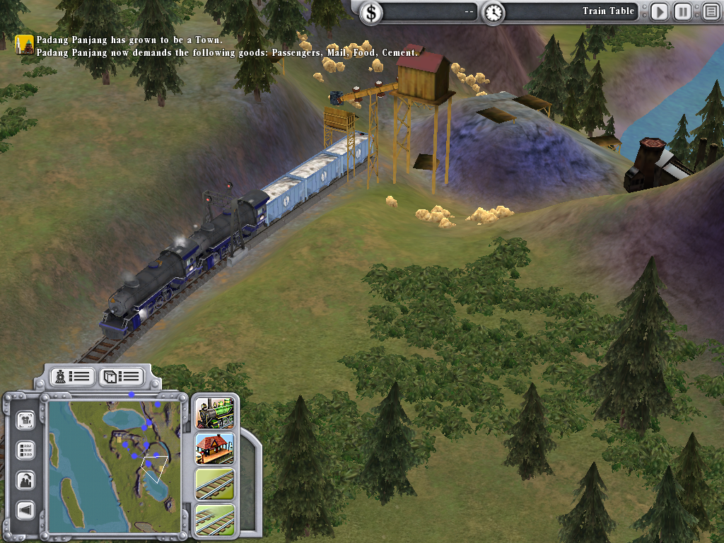

Try to add line "<PassengersAndMailOnly>0</PassengersAndMailOnly>" below "<Diesel>0</Diesel>"
I'll go anlong with Rodea2007 as a possible solution. That is one of the lines that Firaxes put in some and left out of others, here only putting it in where it was needed.
As to the DeGlehn Dummy, there is none in my RRT_TrainCars.xml which is where the Tenders are. You would have to build one or have one built. This is why you don't see the second engine. This could also be why it wont accept anything but Passengers. The 'Why' part I wouldn't know, but the possibility is there. As to having the power and such of a Dual, you made those settings, so even if you set the second unit as a go-cart, it would still have the power. The second unit is just for looks, no more. But you need to get it into your RRT_TrainCars_<map>.xml.

- Mikado Dual and De Glehn Dual
- SMRailroads!0002.PNG (1.14 MiB) Viewed 27147 times
- De Glehn Dual Loading Limestone
- SMRailroads!0007.png (1.37 MiB) Viewed 27151 times
- Mikado Dual loading Limestone
- SMRailroads!0008.png (1.46 MiB) Viewed 27151 times
