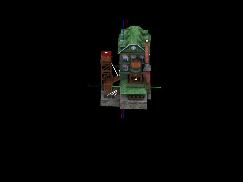

In doing editing on a building, the Brewery, I changed the names to Coffee Plant, aand edited the Coffee_Plant_DIFF.dds to the colors I wanted. In looking at it in NifSkope, it looked fine, correct colors and all. In putting it into the map and playing it, it showed up as purple.
Ant ideas what I did wrong? I've done train car color changing, but I did full image color adjust and added lettering on those. On this it was changing the colors of sections or pixels.
- Map View.jpg (93.43 KiB) Viewed 11405 times
- NifSkope View.jpg (15.06 KiB) Viewed 11405 times
I hope it is...... I used DDS Converter 2 to change from DDS to TGA, edited the file with Paint Shop pro 7, then chenged it back to DDS with DDS converter 2. I have no idea how to control the changing.
OOOps, just checked the program..... DDS is set for nVida, DXT3, Build mpmaps and Save alpha (if any). It will do S3 or nVida, DXT1c / DXT1a / DXT3 / DXT5. Can also 'Add dithering' (?) and 'Fast compress' (?).
DDS Converter 2.1 is free and has worked great, up until this 1 building. I've used it to do the Dock and other editing of DDSs in this game.
Attached is the Coffee Plant building and NIF/KFM files. There are 3 different versions of the cofee plant. Have a look....

The attempt was done in at least two ways. The first was to outline the main roof part, copy it, paste it into a new window, do a 'Red/Green/Blue' adjust to it, copy it and paste it back into the same place. The same was done to the other parts of the roof, adding an Alpha Layer and erasing anything I didn't want affected.
The second way was to select a shade of Red from the roof, select a shade of Green from the matching spot on the first attempt and do a Replacement on all the roof parts. I went thru and repeated it for the rest of the Reds.
First, no Purple was involved, and second, only the roof was changed in one of them, yet all three attempts were Purple. The only common thing was the NIF and KFM files, but if I use the Brewery DDS files, they turn out fine.
Now, if someone can suggest a way to deal with this, I'd be very happy. If someone could suggest a different building, one that has smokestacks, or add smokestacks to the Factory or Warehouse, I'd be grateful.
Any takers???
Any takers???
As a guess, I would as that you are not picking up your tga files or maybe a conflict. In review of the file posted, I see what may be some unnecessary data like the the CofPlnt Files, also I see line 40 make reference to a a ddsery extension instead dds. Everything else looks normal but still looking.

That was the answer!!!
How the last 3 letters of Brewery got there I couldn't tell you as I only highlight and change the first part. But hey, I try not to be perfect all the time, it makes others look bad.........
As to the unnecessary DDS files in there, each was a different set, the CofPlnt being the one I wanted and the others being variations in the DIFF version of the DDS files. Also, when I make changes in graphics using TGA and other types of file types, I tend to leave them in the folders in case someone else wants to either see how it was done or wants to do thier own variation of it
So is the world of computers. Do everything right and it still wouldn't work. First time that I have heard of a computer making up it's own file extension though. My guess is that you have spent to much time on the project, and have become blinded by it. Not the first or the last time, I'm sure.
On the subject of other materials, I follow what you are doing but issue caution with that since this game comes apart at anything. Not only that, the program could actually use them and really cause confusion. Now back to work, since many are waiting to play what ever map you are building.

The affected 'thing' was the file 'inside' of the NIF. "1-4a Rename" didn't touch those.Kenster wrote:Hmm...
Did you use "1-4a Rename" on those files? Just wondering incase we need to look out for this if I ever get a chance to use it.
What may have happened is I have a copy of the part I want to change ( coffee_plant ) highlite the part I want to change (Brewery ) and paste . Sometimes because of my unsteady hand (old age you know....
Tijer - ya, sometimes I do spend to much time on it. Sometimes I get interupted and loose my train of thought. For some reason if i try to click on a NIF file from my on-board video (I use 3 screens, 2 card, 1 on-board) it locks up the whole computer. Ain't figured that one out yet, and I'm not always paying attention to which screen I working from. Then I may have lost 1 of my 4 year old 160 Gb drives and everything on it because I was using it as my VM drive. This game overworked it I think. I have a 8.4 Gb drive strictly for that now, and plan on getting a <5 Gb drive for it.
