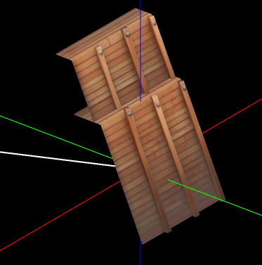

:?: question: Retaining walls
Once I saw it in a map, don't know wichone, but is it in fact the same way handled as tunnels or bridges? That would be logic, but i see a reference in the scenario to it, what is it doing overthere then???
and how does it knows how high, wich side etc...
i saw it once... but where?
or do you see it always in that case?
It should be used when you've got a hill or mountain, next to the track
This is a retaining wall, i want to use it, but how?
Retaining Wall.jpg (24.96 KiB) Viewed 10913 times

Post by RedKnight » Wed Feb 28, 2007 8:10 am
gforce, I've collected some data on how fast Ore is output... it's the only resource that doesn't have 1 (or 0) output. I wanted to verify that it's twice the output of other resources (2.1 cars/year at Small, 3.4 at Medium, 4.4 at Large). But I haven't tabulated the data yet... will do so soon.
I saw tunnels with wooden walls on the Southwest US map. Is that what you're talking about?
