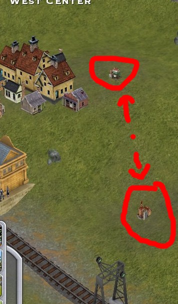

Post by gforce » Mon Feb 19, 2007 4:07 pm
fscale setting continued:
fscale will effect industries green ring
BUT
fscale for industries in a city will effect the size of the building
see screenshot
fscale on industries effects the size of building, ps: the fscale on the other industries outside a city was not affecting their size (green ring)
gczobel
Posts: 16
Joined: Wed Nov 29, 2006 3:46 pm
Post by gczobel » Tue Feb 20, 2007 7:14 am
gforce wrote:fscale setting continued:
The same for decorations.
Post by gforce » Tue Feb 20, 2007 5:31 pm
Also i noticed that it is the same for some other models, fe the building of the coal-mine, probable because this type is ismountainess type, wich is seen as it is a incity industrie, strange to have a parameter fscale for 2 different goals :cry:

Post by gforce » Sat Feb 24, 2007 2:33 pm
the fscale was set in my example to 0.2 (my initial idea was adapting the green ring only)
0.2 as a fscale for the green ring is not so small, enough for single player scenarios (it's a way to enforce players to get up a hill or mountain, when the green circkle is just normal fscale 1, you can most of the times putting your annex in the beginning of the slope, instead of on top of the hill), maybe not for multiplayer, if their accessing a city with multiple players...
Even when you set this fscale for incity-industries, this will ,not affect the green circle of the city. for ismountiness industries it does but also for the building wich occurred very small, almost not vissible fe coalbuilding
I can't change the green ring of the city, you can change fscale for a depot or station and terminal but this will adapt your building and results in the effect that the station is not above the rails and way too small.
