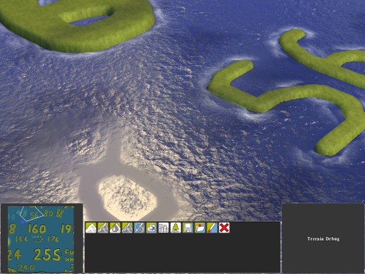

I ran a test in the terrain editor...
I painted "islands" into the terrain height map at the top of the map .tga file, using Paint Shop Pro. The sea is black, R=0, G=0, B=0. Each island is a different, precise shade of grey...
"32 island" - R=32, G=32, B=32
"64 island" - R=64, G=64, B=64
(etc.)
In the screenshot you can see that "56 island" is just above sea level, whereas "48 island" is just visible in the water's surface. ("40 island" is submerged).
To the north, the inhabitants of "64 island" enjoy rising house prices as their neighbours look to move somewhere less liable to flooding.
This shows that water level is at about RGB = 48,48,48
water level is R48 B48 G48.jpg (64.01 KiB) Viewed 8361 times
