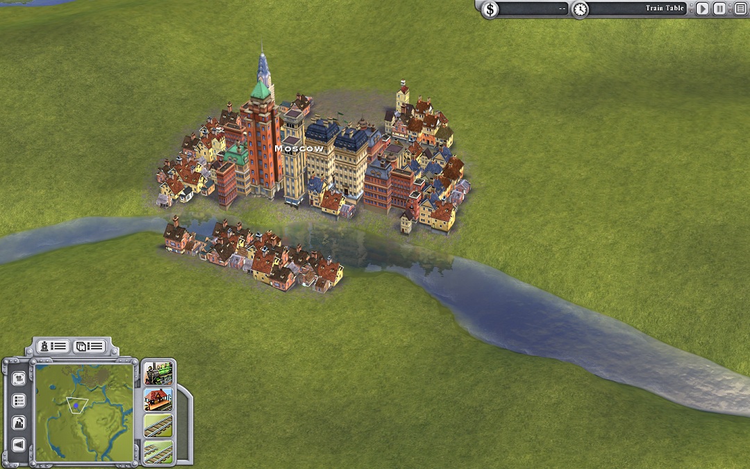

And when I said the cities shrink I mean in the editor they do. It's just really weird because after I save the map or lay something down, suddenly all the cities on the map have gone down a size. Then they go down another size until everyone is a village. Do you know what causes this error in the editor?

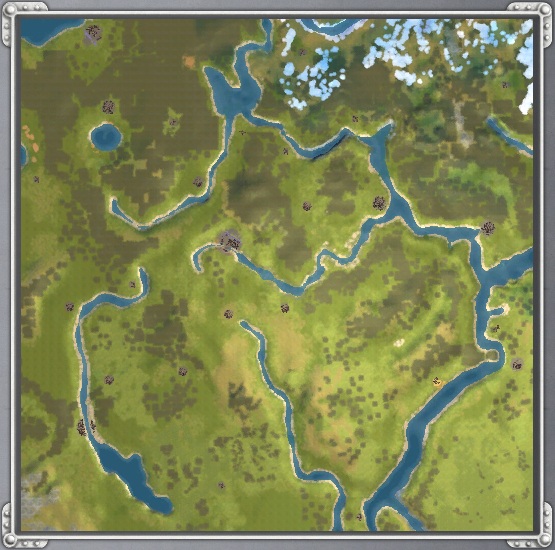

EDIT: Here is a shot of the map. Geography is nearly done being laid out, with just a few touches remaining. Been looking at a slew of topography maps trying to get the elevation right, but its a real challenge - Russia is so big, and the space between cities is eyeballed at best on my map!
EDIT 2: And by done being laid out I mean the elevation. Obviously the textures haven't been placed yet.

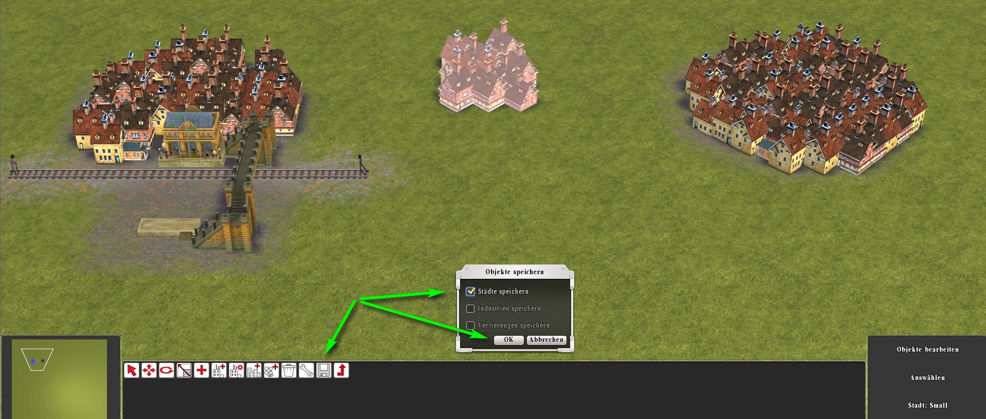

I can only hazard a guess you may not have clicked all the required save buttons as shown below.
Re: Western Russia
I did click it, unfortunately. Its just as I am editing this happens rather than when I come back to it. It was rather annoying when I tried play-testing the map but found none of the 'cities' had anything to offer, as they were all villages...

Another update!
As you can see by the layout I have most of the geographical features in place. Russia is a very forested land, with wooded plains to the south around Tambov and Lipetsk, stretching to Saratov. Meanwhile the space between Moscow and St. Petersburg is a deciduous forest orgy. The same can be said of the terrain east of Yaroslavl stretching to the Urals.
The tree placement looks boxy in this placement, but I assure you it's not that boxy in the game. I guess it hasn't updated the look? No idea.
Either way, working on getting it sorted. The cities are STILL reverting down a size, which is annoying. However, everything else is coming along nicely.

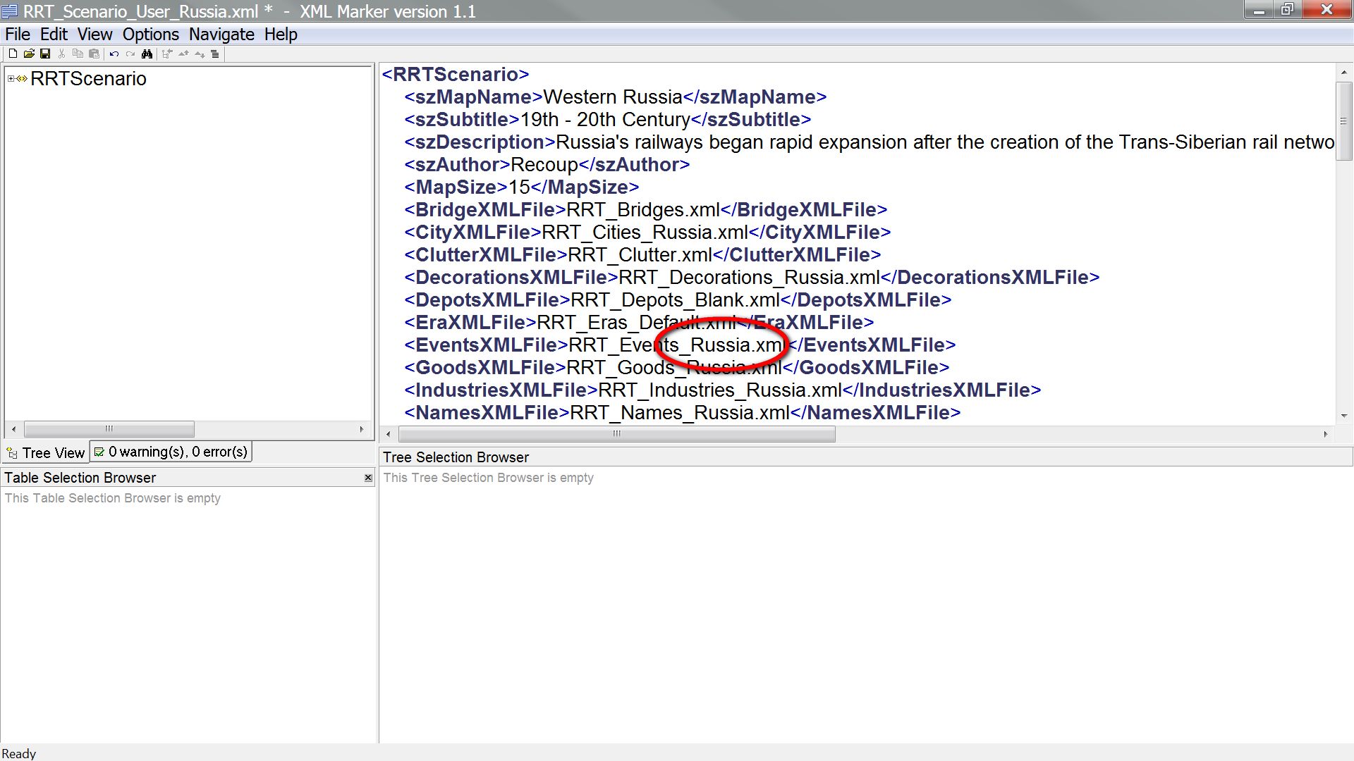

Thirdly, the events file has to be referenced properly in the Scenario file, see screenshot.
