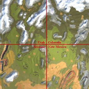

Howdy Partner, This here is the Four Corners Dual Map - a version to play against AI, and a Solo version for those with a pioneering spirit. It features an open pit copper mine, new trains, traincars, some new industry... Now a'fore you jump right into it, you be sure and read this Readme file so's to get off on the right foot. See ya in the Four Corners sonny!
