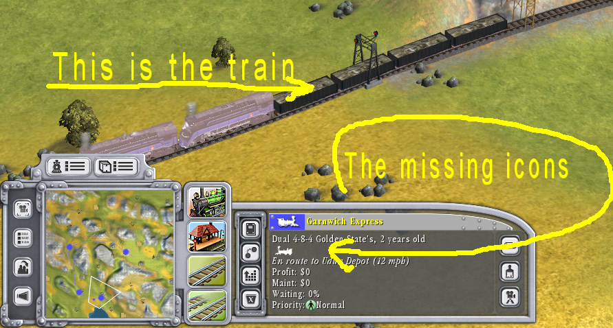

This is still a Beta version. I am trying to build long string of industries, like
Passengers –to- Iron Mine(Iron Ore) –to- Iron Mill(Iron) –to- Machinery -to- Gold –to- Bank’ and I have run into a problem with the product and train car icons.
Specifically with the Iron Mill Industry and the IRON Goods.
In the globals there is a “Goodâ€

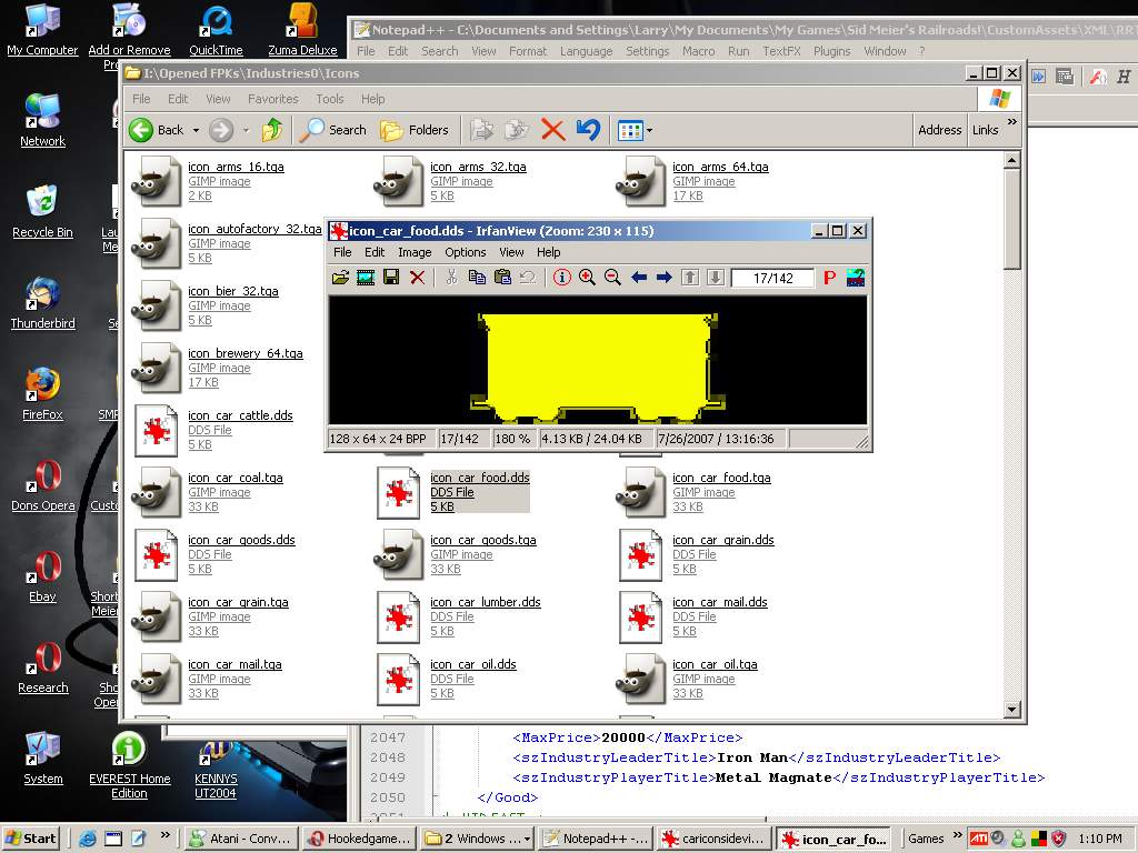

The file you are talking about is not an Icon. It was something that firaxis was goint to use, but chose not to, alot like updates for this game...
The yellow silhouette in the pic below is what those are. There are one for most of the original cars. The "Icon" you are supposed to see when you are selecting cars for your train to haul (I think this is what you are talking about) comes from the TGA file in the file I sent you:
<BitmapCar>
<szFile>fourbear_car.tga</szFile>
<uiX>96</uiX>
<uiY>48</uiY>
<uiWidth>32</uiWidth>
<uiHeight>16</uiHeight>
</BitmapCar>
It is a 'Icon like' file that has up to 30 car silhouetes on it (see below). Each "car" is 16 hi and 32 wide. The upper left car is 0/0. The next car to the right is 0/32. The car below the first is 16/0. So, in going to the right, add 32 to the bottom number. In going down, add 16 to the top number. If you draw this out to 6 boxes wide and 5 boxes high, and put the numbers in them, you get the layout of the CarIcon TGAs. The lower number is the X and the upper number is the Y in the code above. At that site you should see the Iron Car I made up.

I see. You have it and I don’t.
I have completely reinstalled the game, freshly downloaded and reinstalled the necessary Scenarios and still getting blank icons for the trains.
These are screenshots taken after the cleanup.
Then I replaced the SDSIndustries0.FPK file with the one you gave me (both are the same size), still no Icons.
I am ready to give up.
