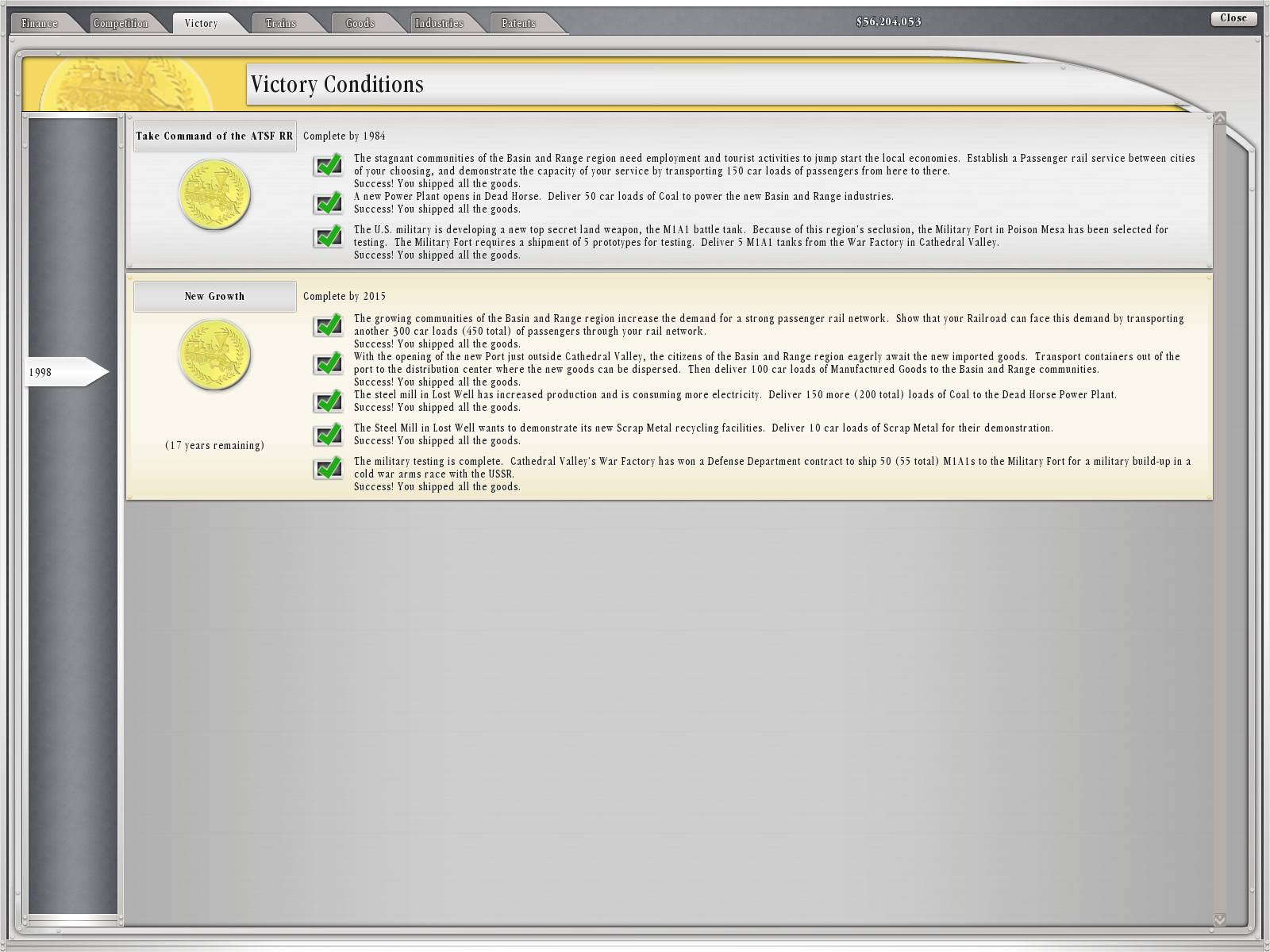

- Victory screen
- victory.jpg (199.01 KiB) Viewed 14149 times
