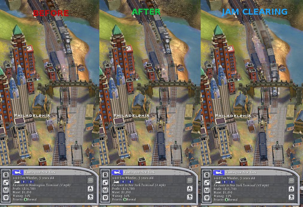

Illustration
Turn train illustration.jpg (171.99 KiB) Viewed 119819 times

I will tend to run a train back past the last signal or two onto the last passing track, then repeat the process to turn it again to its original direction. The train will wait at a signal and therefore leave a clear path for one of the other of the trains involved in the jam.
