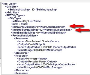

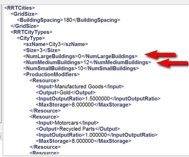

OK, I have narrowed the problem down a bit in the city file.

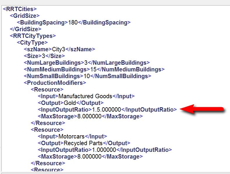

First, I increased city spacing to 180. Then I found a decimal mistake in the InputOutput ratio for gold. But even correcting that did not seem to help, probably because there was no gold production. Finally, setting NumLargeBuildings to zero stopped the crash on city growth.
So it seems that something goes wrong when the game tries to place one of the Large Buildings, though I still have no idea what.
You could try to pinpoint the culprit. Or you can set NumLargeBuildings to 0 for city size 3 and enjoy the map.

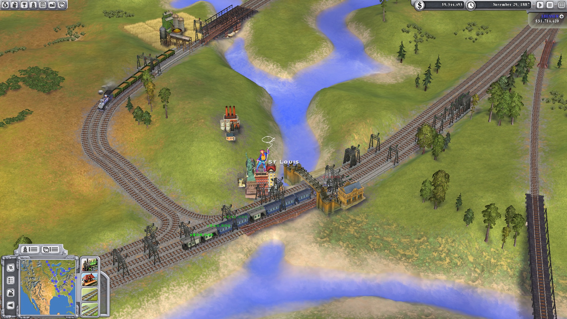

OK! Crash solved! Here are the 4 items that Karsten mentioned.
1. Changing <NumLargeBuildings> from 3 to 0 solved it! Take a look at this screenshot. The city, St Louis, is on the water. Is it possible the game engine tried to put a large building in this city, but there was no place for the building to be placed?
2. I also changed <InputOutputRatio> from 1.5.000000 to 1.500000 but as you say I do not think this was causing any obvious problems.
3. I changed <NumMediumBuildings> from 15 to 12 as recommended, but this was not the solution to this current crash. Of course who knows it could've caused problems, later.
4. I changed <BuildingSpacing> from 80 to 180 as recommended, but this was not the solution to this current crash. Of course who knows it could've caused problems, later.

Re: Crash on NAFTA PHASE II map (audio.log info)
Thanks for testing this.yonglove wrote: St Louis, is on the water. Is it possible the game engine tried to put a large building in this city, but there was no place for the building to be placed?
I have a hunch that it could be related to the monuments, which are listed as simple buildings in the City XML. It MAY be that they do not move out of the way when a large building is placed, because in a standard map, there is one monument per city. They do make way for station tracks, mostly...
