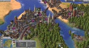

When I ran Devon (the copy available on our map database) yesterday, it crashed to desktop within 20 minutes. I then unpacked the .fpk and restarted today, and it ran without a blip to finish all victory conditions (check out that massive Plymouth conglomeration in the screenshot!). :D
I also note that there are three towns called "The nameless town" in the Devon map. SMR seems to take that in its stride, but it could also be a source of complications. :mrgreen:
