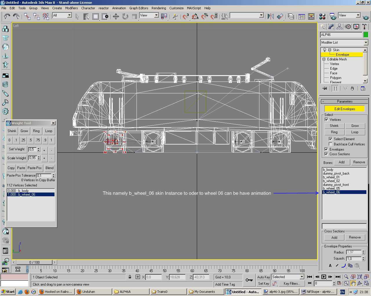

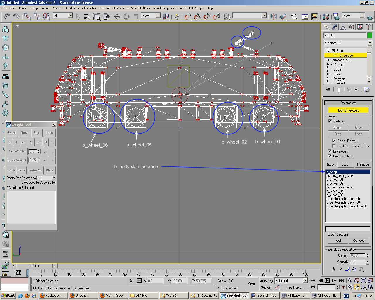

Every model with have animation alway have SkinInstance, because without that the model will not be animated, I use 3ds max and this software have tools for that. and if you trying to edit any Trains with a kind 3d program, so you have to re-SkinInstance that model if not as I said above the model will not be animated and Potentially to occur error, This happens in GP38-2w CN4769 (provided by BB), if you give Kfm file to driver an animation the game will CTD, for this one I have already done with re-skinInstance using 3ds max 8, and now you can use the machine it on the your map complete with animation like any other trainshisty wrote:Hello for all, would like, if possible, some help, I am trying to edit some trains using the blender, I opened and modified the model and exported for.nif again, I opened the model in the nifscope and added the necessary information, but when I try to use the model in the game just appears a red ball.

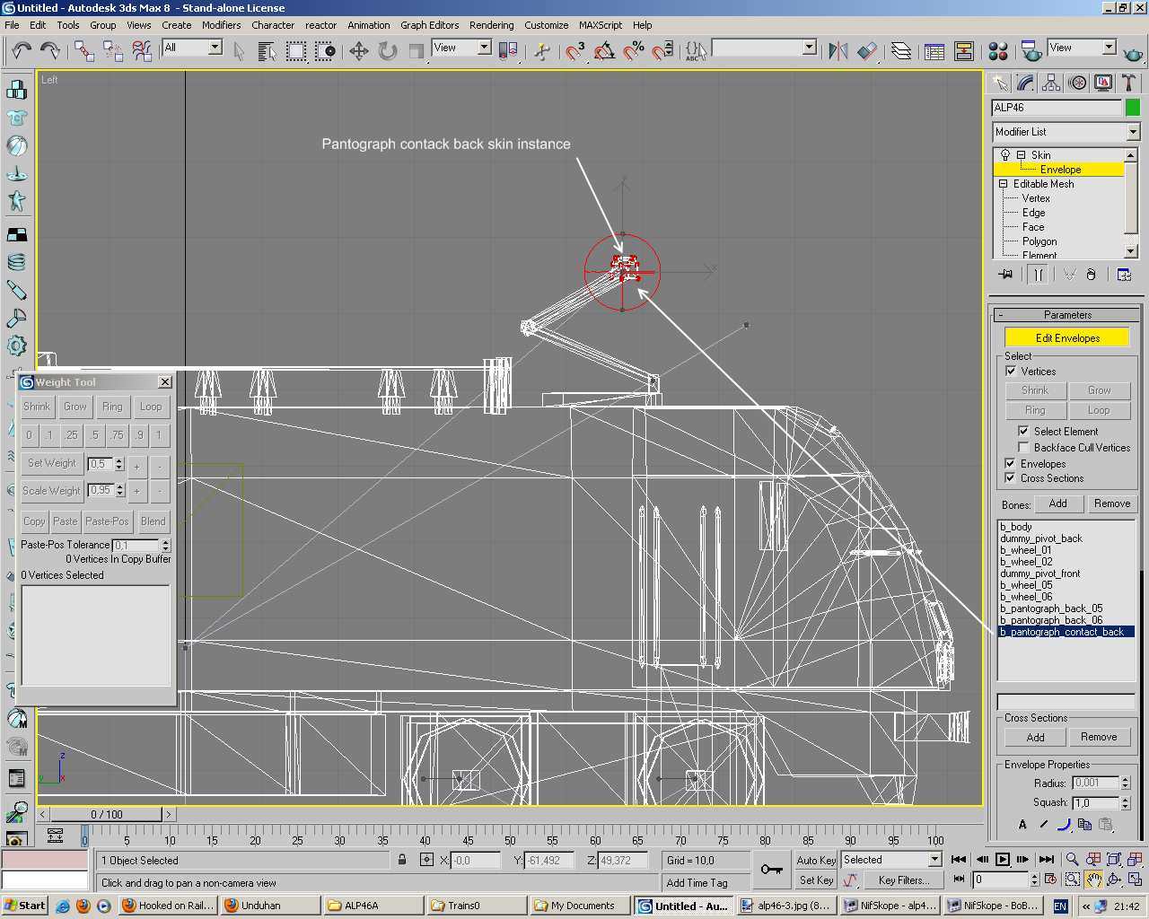

if you have the ability to run 3d programs especially 3ds max, I do not think it would be so difficult to give an animation on a model, it only gives the skin vertex Instance to be animated, for the model you are but wheels you must also provide the pantograph animation, but if you do not have the ability to run 3ds max, I can not say anymore.histy wrote:After some days I finally finished! It still has some problems, mainly with the animations that I don't know how to solve still, but the basic is ready! Thank you to all by the help!
I just tried the your model for the edit with 3ds max but your model can not opened in 3ds max because an error occurred on the skin Instance, but I will try back with delete skin instance and open again in 3ds max to add a new skin Instance

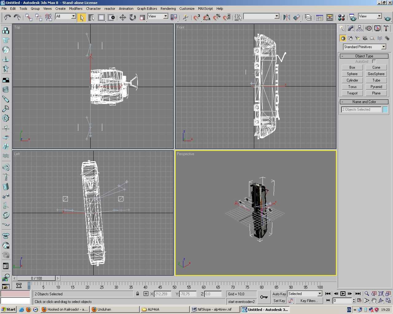

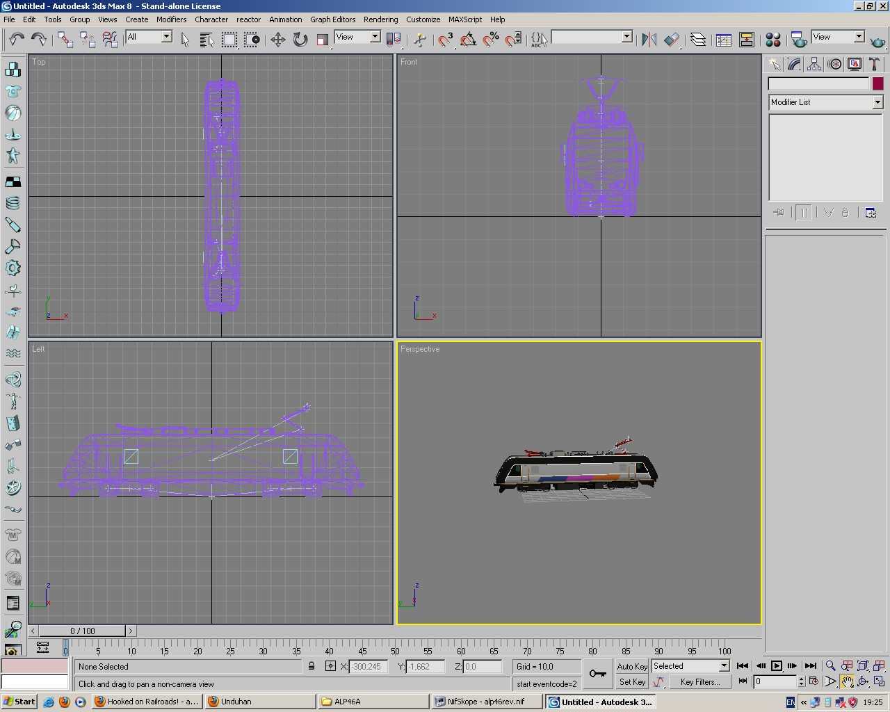

It just opened with 3ds max 8 after deleted skin Instance in Nifscope, if not can not opened by 3ds max, btw you have 3ds max 9, so why you can't give it animation.....histy wrote:Hum, This model was edited in the blender, but is stranger not to have opened in the 3dsmax, I have the 3dsmax 9 here also and I get to open it without problems.
Notice to the pictures in this below

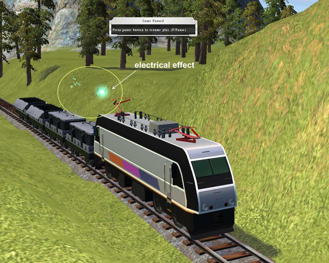

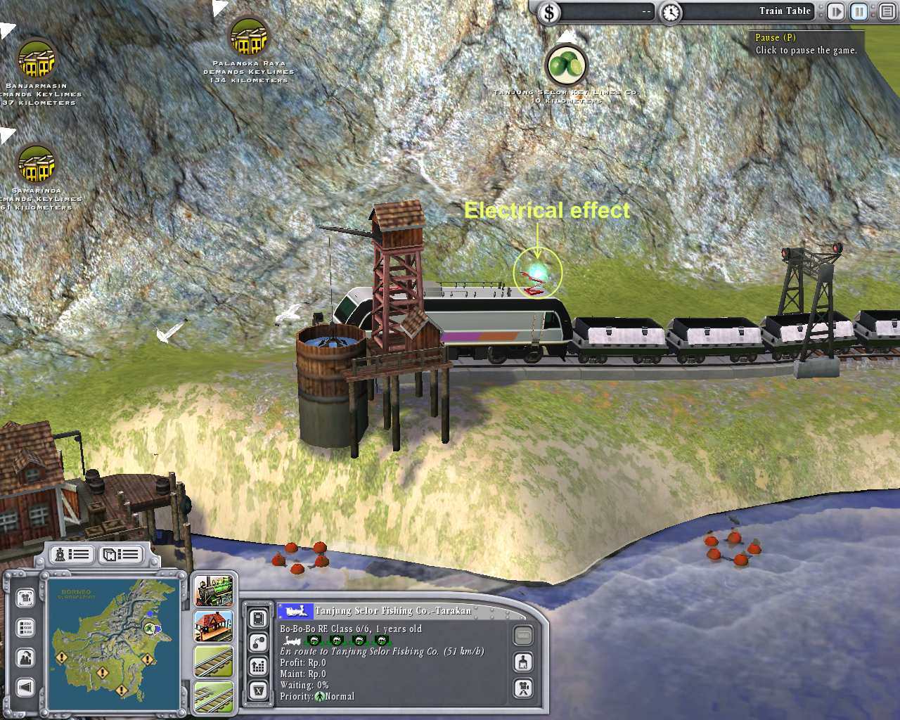

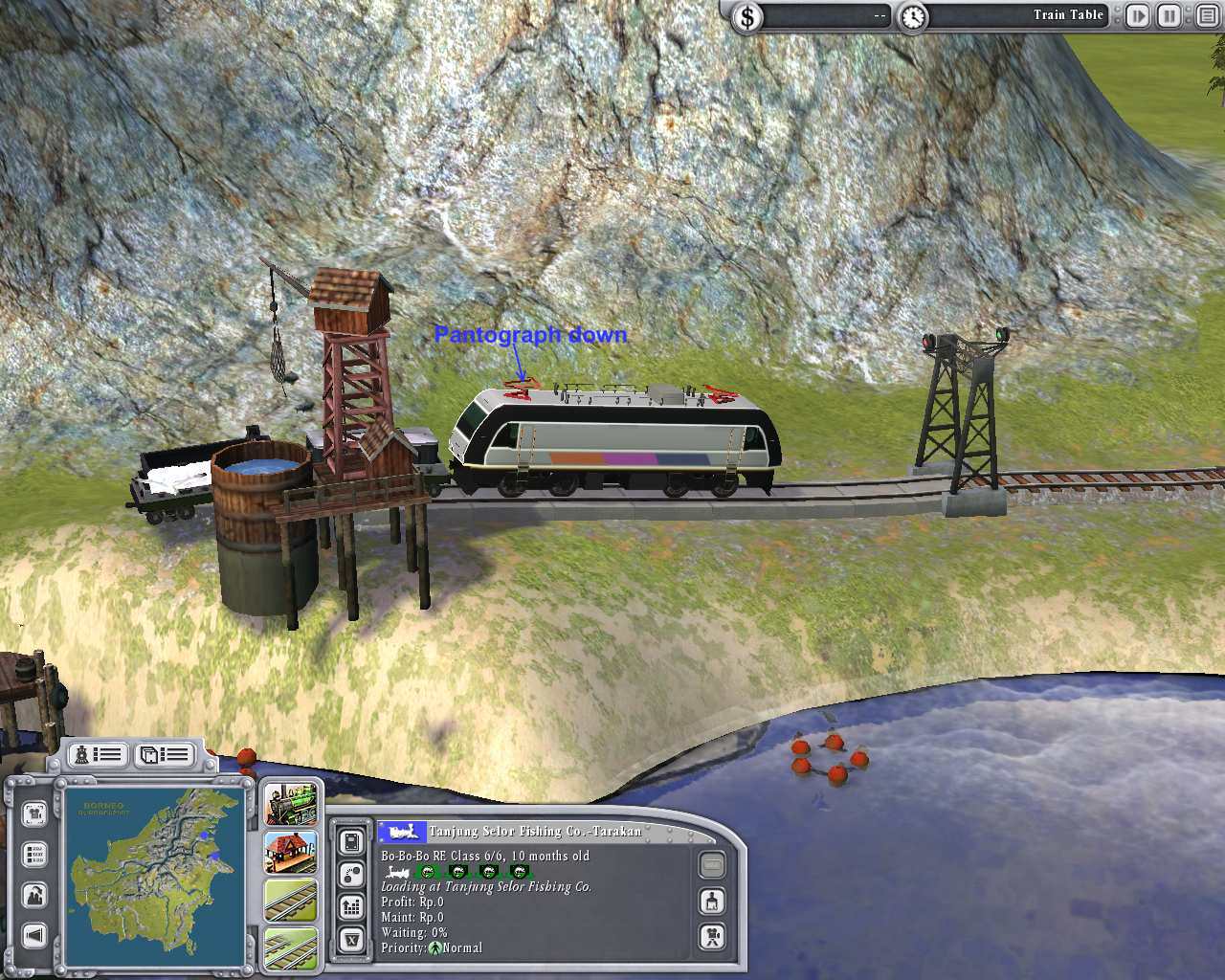

Please see ALP46A with animation on Nifscope at here http://www.youtube.com/watch?v=1tdyNbmGd0U
Notice to the Pictures in this below
there are ALP46A with kfm to driver his animations, after edit and reskin Instance by 3ds max 8
Without use KFM file you can not see those effects
