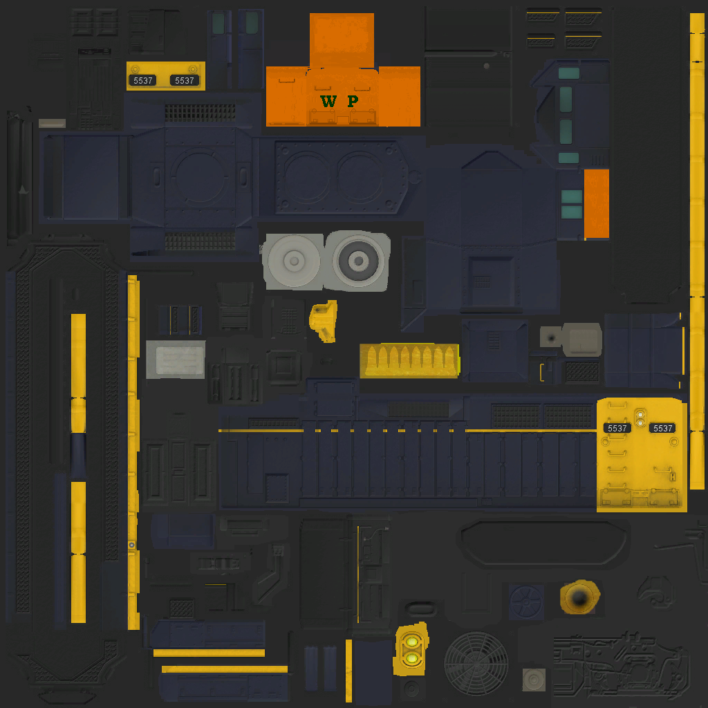

Decided to make a Western Pacific GP40.

Post by Burlington_Northern_3140 » Thu Apr 24, 2008 12:34 am

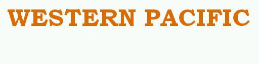

The decal, I noticed as I looked to see if I was painting corerectly, is already in the right spot, but after painting sfbillboard_decal to WESTERN PACIFIC in orange and pasting that in the sfbillboard_decal_spec and filling the orange in with black assuming that sfbillboard_decal_spec was to signify were color was translucent, the decal was white were it used to be translucent and the railroad name, the orange words WESTERN PACIFIC that I typed earlier, writen on it. How do I restore the translucence in paint?

Post by Burlington_Northern_3140 » Thu Apr 24, 2008 3:39 am
I am using paint with PNG files. here are the files: the decal that is not working, that I have lost the back up to is: sfbillboard_decal and sfbillboard_decal_spec, a working decal for the number written on the side of the cab: sfbillboardnumber_decal and sfbillboardnumber_decal_spec and my progress on the model: sfbillboard_Gp38_2_diff, all png files. It seems the Niff files are not allowed so i hope you already have the BB_BR_GP38. If not, it is in the Building blocks thread.

Post by Lowell » Thu Apr 24, 2008 5:06 am
when you import the files and make them png...convert them to PNG 32 or 64 RGBA ... you must import the alpha with the model, or your paint program will fill it in with the fill color, which is in your case white. Likewise when you merge the layers, merge the visable...if you merge flat all...the transparancy is erased and filled in with the fill color or background.
So always edit in PNG...convert the dds files or whatever into the RGBA makesure the A is there for Alpha.
Then your decals will work properly as transparent. I made one transparent, try this one and see if in the Nif file it shows up right. Also you can move the decals around with the x and y settings.

I took the first, opened it in GIMP and told it to 'Alpha' the white. (the white is now clear) I resized it to 512 x 128 and saved it(WP5357_decal.dds). I then replaced the orange with black, renamed it and saved it(WP5357_decal_spec.dds).
Now the number. I think a different number would be good, so I'm doing it as 5357. I'm doing it in orange also. I saved it as WP5357number_decal.dds. I then changed the orange to black and saved it as WP5357number_decal_spec.dds.
