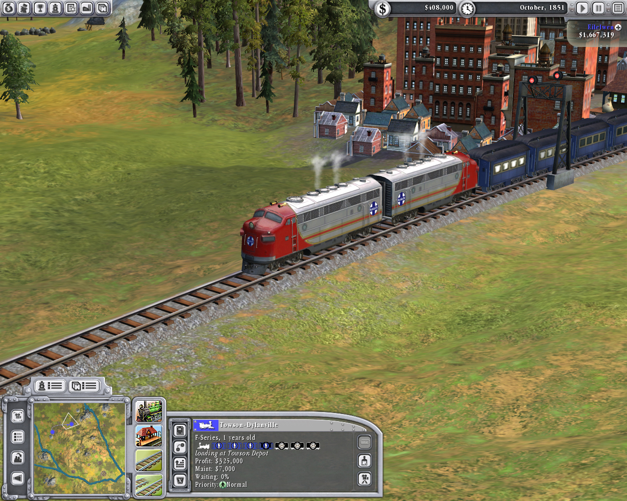

seing the pic of the 2 f series led me to wanting to make one of the gp series
my 2 gp series
my 2 gp series
eilelwen's 2 f series
Post by snoopy55 » Mon Dec 04, 2006 9:52 pm
eilelwen wrote: hmm with the two A units I'm not sure what could be causing that, what files do you have in your custom assets mainly just the .fpk files.
The top .jpg from ace13567 (one up) is just what I had. I can't remember if they were back-to-back or both forward tho.

Post by eilelwen » Tue Dec 05, 2006 1:08 am
the back to back was my original that I released a month ago, and if you deleated everything properly should never reappear.
the GPs look nice :), eventually I plan to reexport the GP and turn it around, so that they are back to back. that will probably happen this week as well.

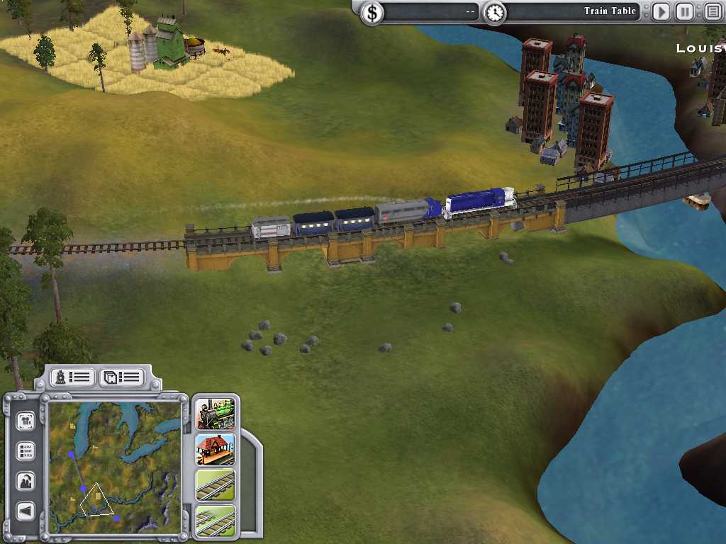

Post by snoopy55 » Wed Dec 13, 2006 11:02 pm
I modified the files and got a GP7 w/F-Series and a GP38-2 w/GP7. They do need different name tags and roundhouse discriptions, at least I think that's all I need. :roll:
Here is the change for the first one.....
<szName>TAG_NAME_GP7</szName>
<Year>1949</Year>
<szManufacturerName>EMD</szManufacturerName>
<szModel>EMD_GP7.kfm</szModel>
<szDummyModel>EMD_GP7_Dummies.nif</szDummyModel>
<szTenderCar>A Units Dual</szTenderCar>
<szCar>_v2</szCar>
And here are the pics:
The GP7 w/ F-Series
The GP7 w/ F-Series
The GP38-2 w/GP7
The GP38-2 w/GP7
