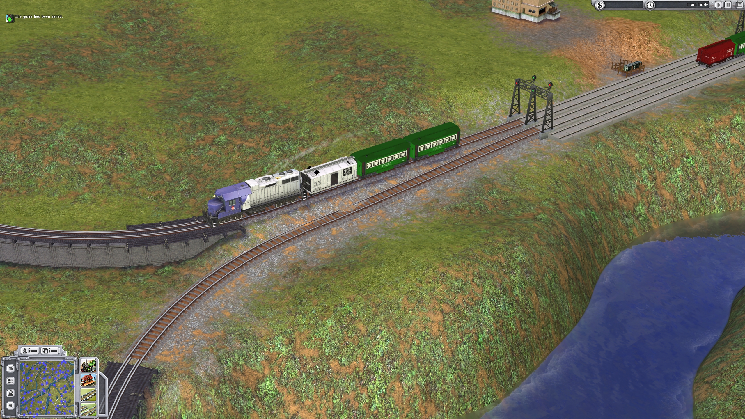

What this also prompted me to do is something I've wanted to do since SMR first arrived. Write a utility that can edit saved demo files. The main reason for this is to fix up scars in the landscape from changing laid tracks. The map TGA is stored in the saved file, both as it's original form and the modified one from laying tracks etc. The map data is not in 24bit color depth as the source map file is, but 8bit color depth. Makes them much smaller.
So that's quite useful for me as I can fix up the scars and textures to make it bewtiful again.

A little grass between the tracks.

It's especially nice to fix up where bridges meet the land.

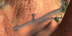

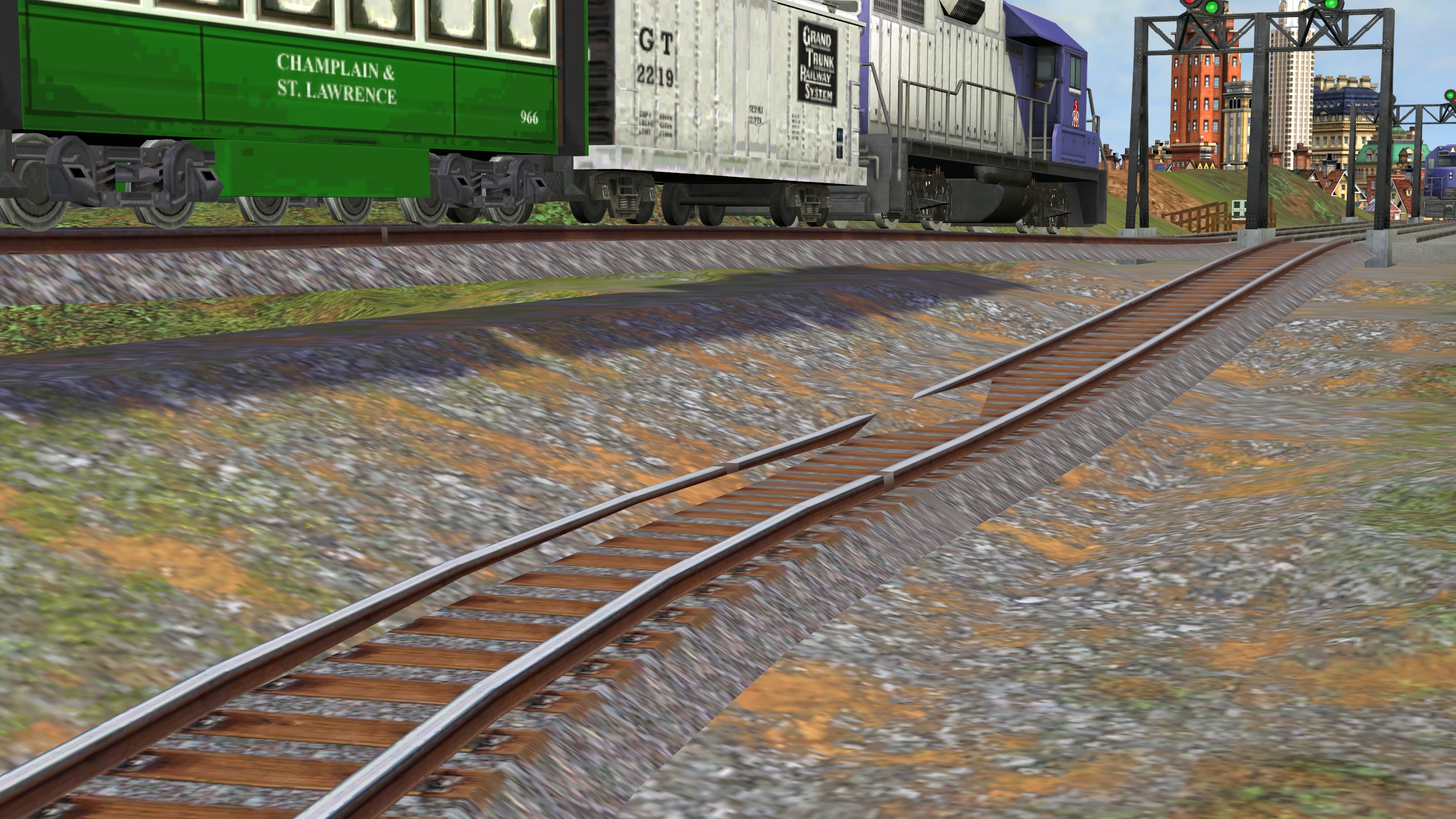

An illustration:
As you can see, the smooth slope was ruined when the junction was added. This in my view is a really aesthetically nasty habit from the game. Do your methods have some possibility to side-step this?
PS. The "halt" for building track isn't bad on your save. There are some huge maps. It's possible to virtually "freeze" the game. Interesting that Windows reports the game as "not responding" for the duration. For me, anything below 5 seconds is tolerable.
What impressed me is how you were able to patch back up the terrain. And I began to wonder if your methods could side-step one of the annoying game issues: ends of track pieces are enforced level.
An illustration:

Not to sure what you mean by 'side-step'.
The technique only patches up the height map, texture map, tint map and others, after the game engine has done it's thing.
It could certainly fill in the space below the track that is made from adding track points, but only up to a point.
In the save file I shared, I left a specific spot for later to work on. It demonstrates perfectly how the game engine renders the 3D space.
If you get up close, you can see there's a gap still underneath the track, and as you've noted, the end track level thing which bugs me too.
Problem is bumping the height up one level under the left track would probably partially cover the track next to it. The 3D space doesn't have a fine resolution. The height marks are spaced and the engine joins them with a slope. You cannot have a completely vertical face with this engine on the terrain.
That makes it hard to fill gaps.
Nothing can be done about the end track levelling from what I can see, so far. I'm still working through the saved game structure and logic would say at some point track end points should be recorded somewhere so the engine knows where to put them. Whether or not they can be orientated by angle will be the thing to look for.
I suspect they would have an angle setting on the x-y plane so they know which way to point but that's about it. That would explain why it always levels out the track end joins.

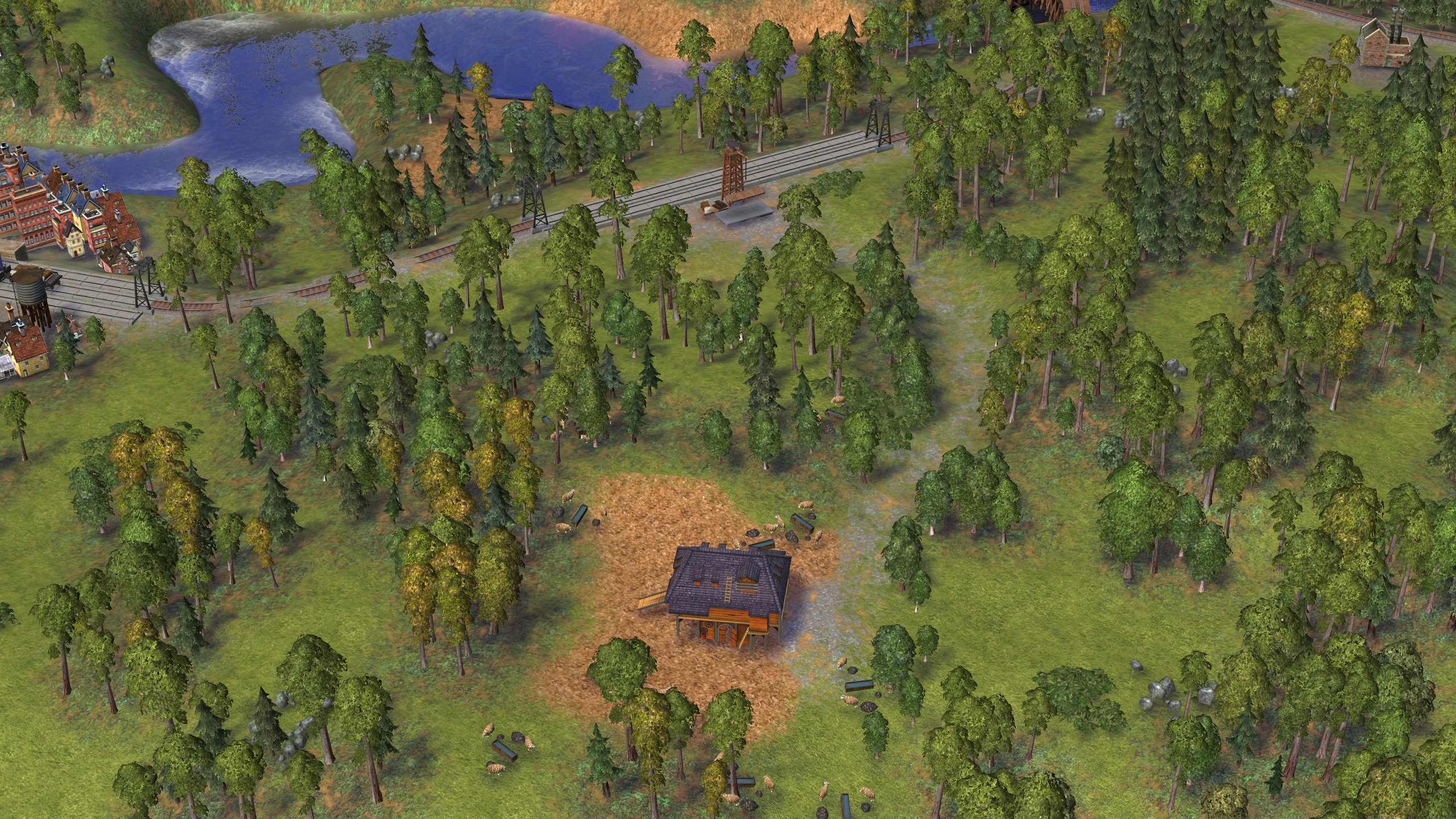

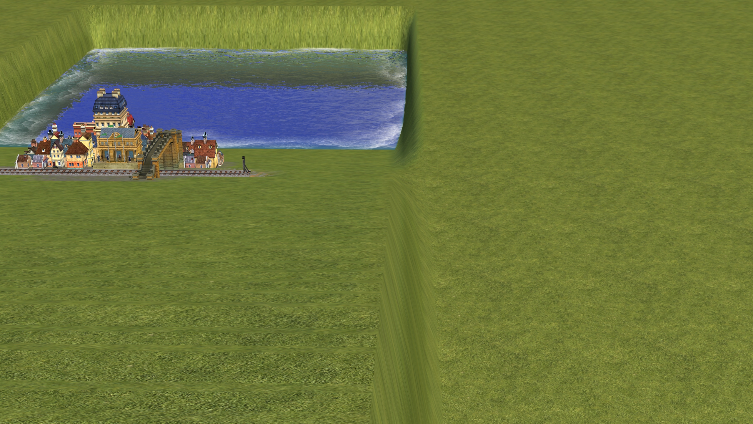

Took a (not so) quick look at the parts at the end of a saved game file to see if anything look obvious re: track positions. Nothing stood out. But I did take a look at an industry block of data. Worked out where the location is stored.
So I moved the shearing shed, cut out a track to the landing and moved a bunch of trees around. Also modified the textures a little.

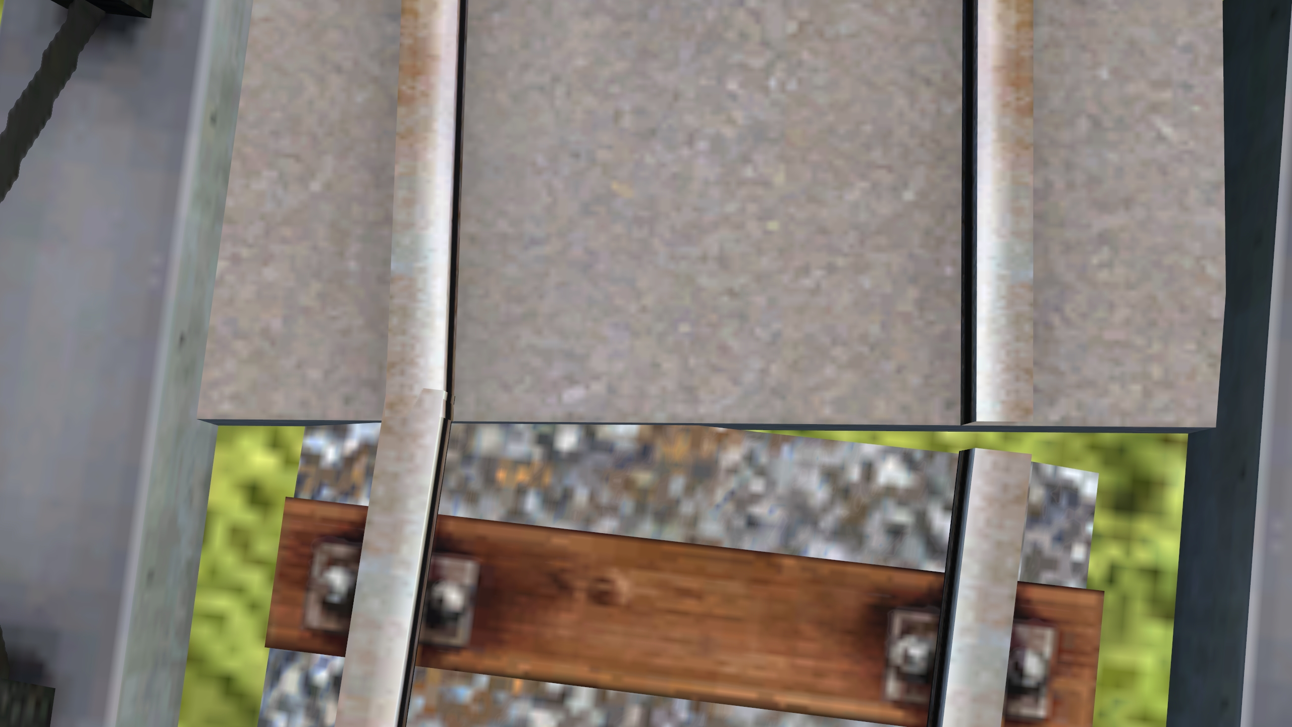

I found some fields in the saved game file that relate to track positions and endpoint yaws. For those not familiar with yaw, it's one of three words used to describe an angle around a specific axis in space. If you google yaw, pitch and roll you'll get all the info about that.
In the saved game file, it stores the x, y and z position of each end of a piece of track. The track is then drawn between each endpoint. Along with x, y and z is the yaw for it. But the pitch and roll values are not stored, thus, track endpoints will always be level.

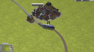

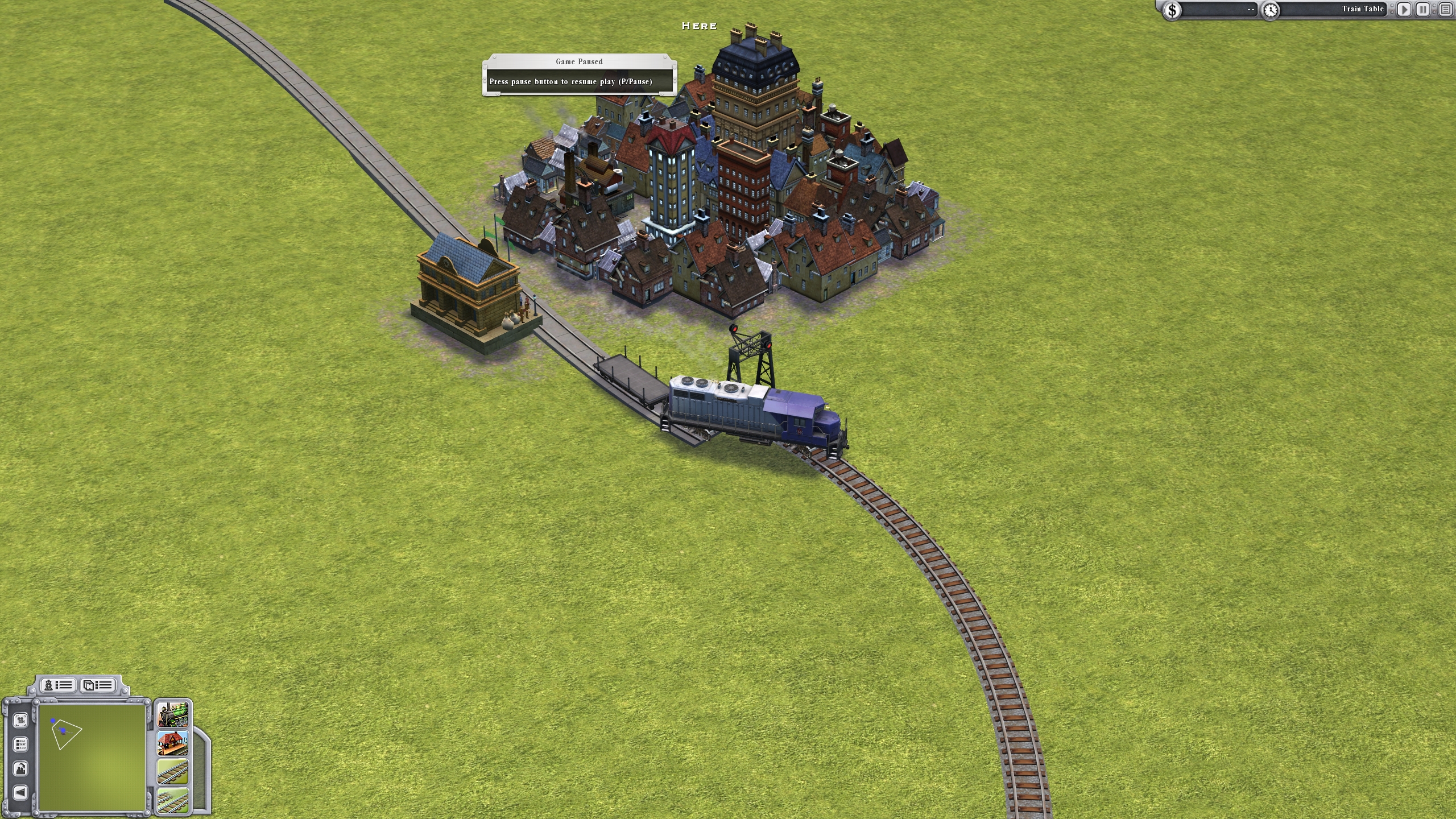

In this pic I've moved the endpoints of the platform track. The engine tolerates this, to a point, and will simply follow the position of the track even if they're not lined up.
Here is a close up of the yaw modified for an endpoint. Again, the game engine will just follow the track wherever it is. You can set the yaw to 90° from the original and the train still follows along.
So, track endpoint levelling will always be a thing, as I've said.
