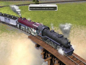

See to the picture belowJancsika wrote: Same here!!![]()
Can you make them to tie up back-to-back, with steam engines? Smoke blowing in the right direction?.
Re: Two engines?
The only thing is steam engines when used as duals are found facing the same direction. Not like diesels where they can face back to back or front to front.
