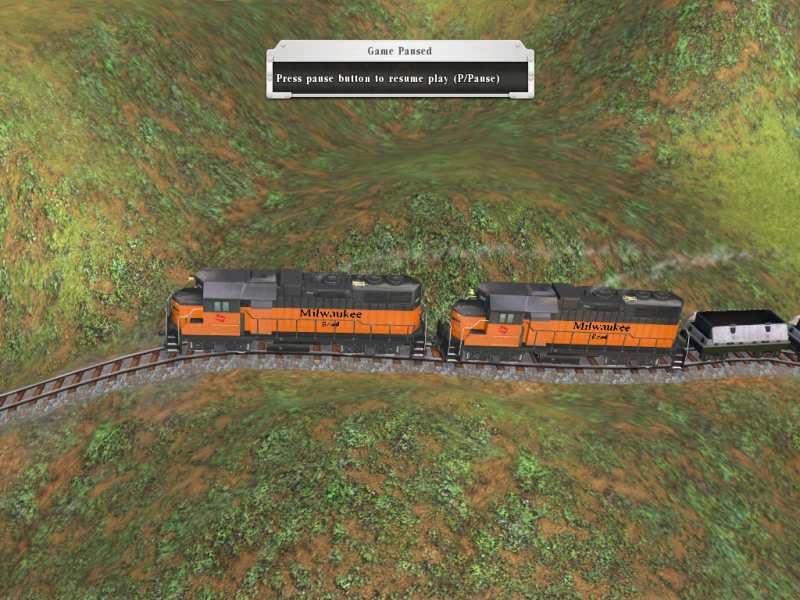

dwax wrote:I can't get that code for the duals to work. put it in the files like you said. get a single Milwaukee Road just fine in both of Quad City Lake In Winter and The Island Of Sodor Map. Did you try it Jancsika?
You must be missing something dwax, that code is correct, just I think you did an mistake when write it
see to the picture below
Note: please post here your RRT_Trains_yourmap.xml and RRT_TrainCars_yourmap.xml, I will rewrite them with those codes
Re: Two engines?
Post by dwax » Mon Apr 13, 2009 11:47 pm
Yep, I made a mistake in the Train cars XML Got it working now. Thank you Rodea! :)

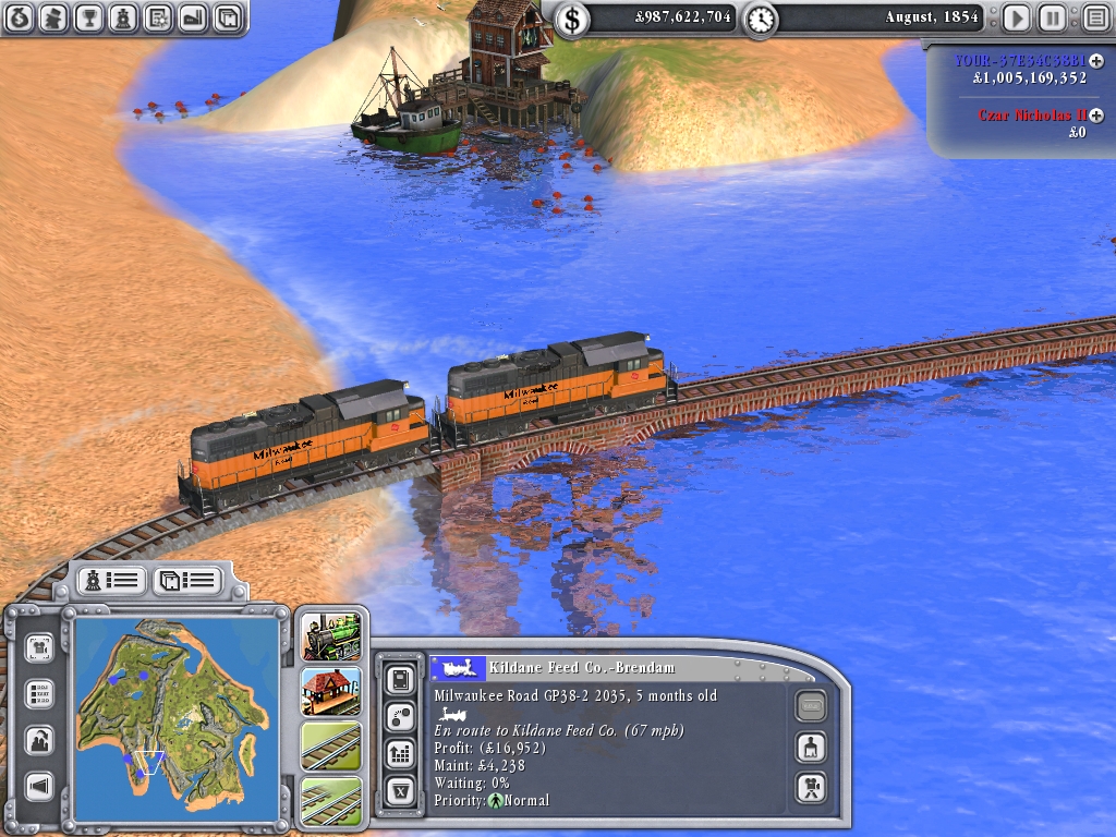

Re: Two engines?
Post by Rodea2007 » Tue Apr 14, 2009 12:12 am
Please Notice, that very important to you know how to rewrite your XML files
For examples we want to add tender car to RRT_TrainsCars.xml
<RRTTenderCars>
<TenderCar>
<szName>MR2035 Tender Car</szName>
<szModel>Milwaukee_Road_2035.kfm</szModel>
<szDummyModel>EMD_GP38_2_Dummies.nif</szDummyModel>
<RunLength>30</RunLength>
</TenderCar>
</RRTTenderCars>
If in your RRT_TrainCars.yourmap.xml not have yet Tender Car list you must add all lines above to RRT_TrainCars_Yourmap.xml under line "</RRTGoodCars>"
but if your RRT_TrainCars_Yourmap was have other Tender Car list so only lines with blue color you must add to RRT_TrainCars_Yourmap.xml.
I guess dwax problem is he put all lines into RRT_TrainCars_xxx.xml, meanwhile he was have other tender car list in his RRT_TrainCars_xxx.xml.......... :D

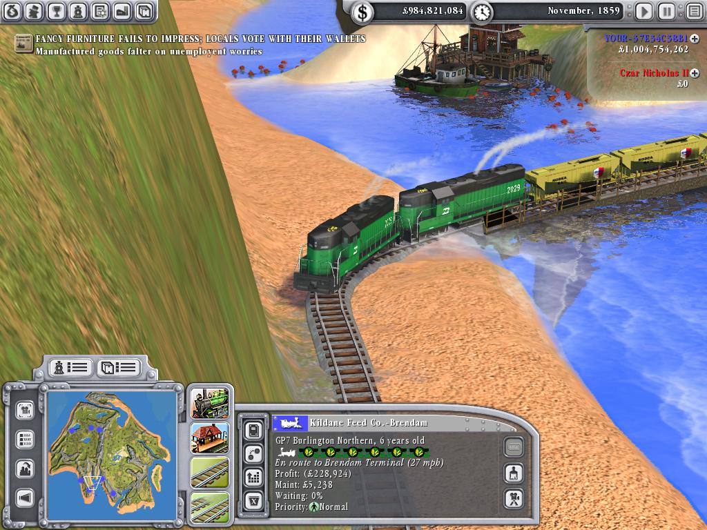

Re: Two engines?
Post by dwax » Tue Apr 14, 2009 9:43 pm
That works with the GP-73 too! :mrgreen:
Re: Two engines?
Post by Rodea2007 » Tue Apr 14, 2009 11:38 pm
dwax wrote:That works with the GP-73 too! :mrgreen:
Yes....Now you can make all trains have Tender......... :lol: :lol:
