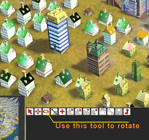

another issue in editing a map, how to place a coastal industry field such as fishery and port?
every time i start to play (test) the map, the land (beach) near the fishery will be cropped out and the fishery now standing on the sea :(
Re: integrated Train Table
Post by Jancsika » Wed Sep 08, 2010 6:27 pm
You have to drag and rotate them parallel with the shoreline. It’s by trial and error. Avoid high shorelines.
The arrow is for select, the Cross Arrow is for; Move.
When you click on the wrech icon, it will show the effect of changes you made.
And don't forget to save here. The floppy icon.
PS.....and the little houses are for teaser :lol:
