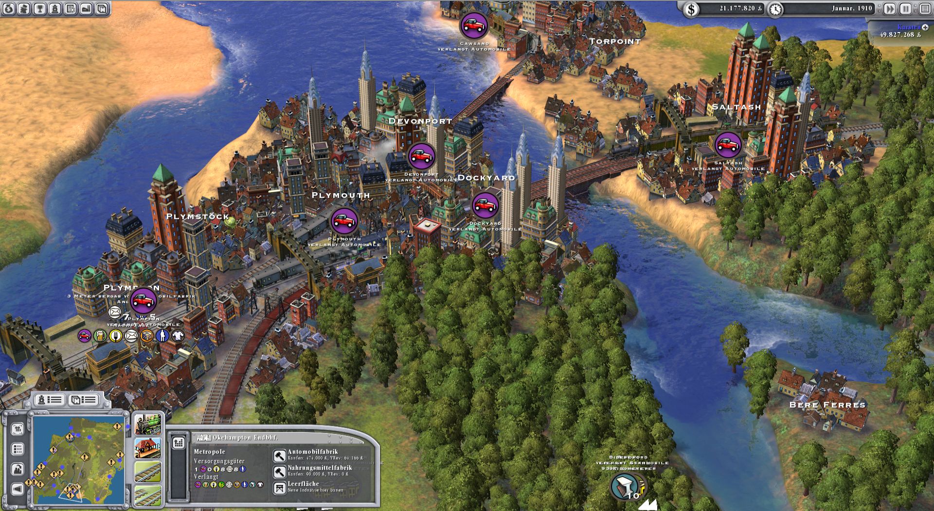

When I ran Devon (the copy available on our map database) yesterday, it crashed to desktop within 20 minutes. I then unpacked the .fpk and restarted today, and it ran without a blip to finish all victory conditions (check out that massive Plymouth conglomeration in the screenshot!). :D
I also note that there are three towns called "The nameless town" in the Devon map. SMR seems to take that in its stride, but it could also be a source of complications. :mrgreen:

Love the Plymouth pic.
Actually I hope I can run this map again as it is a beautiful map, and provides lots of interest. Fun to build the small out of the way towns, in the woods, into metros.
Reviewing your Post, Karsten, I realize the comment about some "NO NAME TOWNS" or such. I did not find this and wonder where these towns exist as alltowns I see have names.
Maybe I am not understanding what or where you are seeing this.
