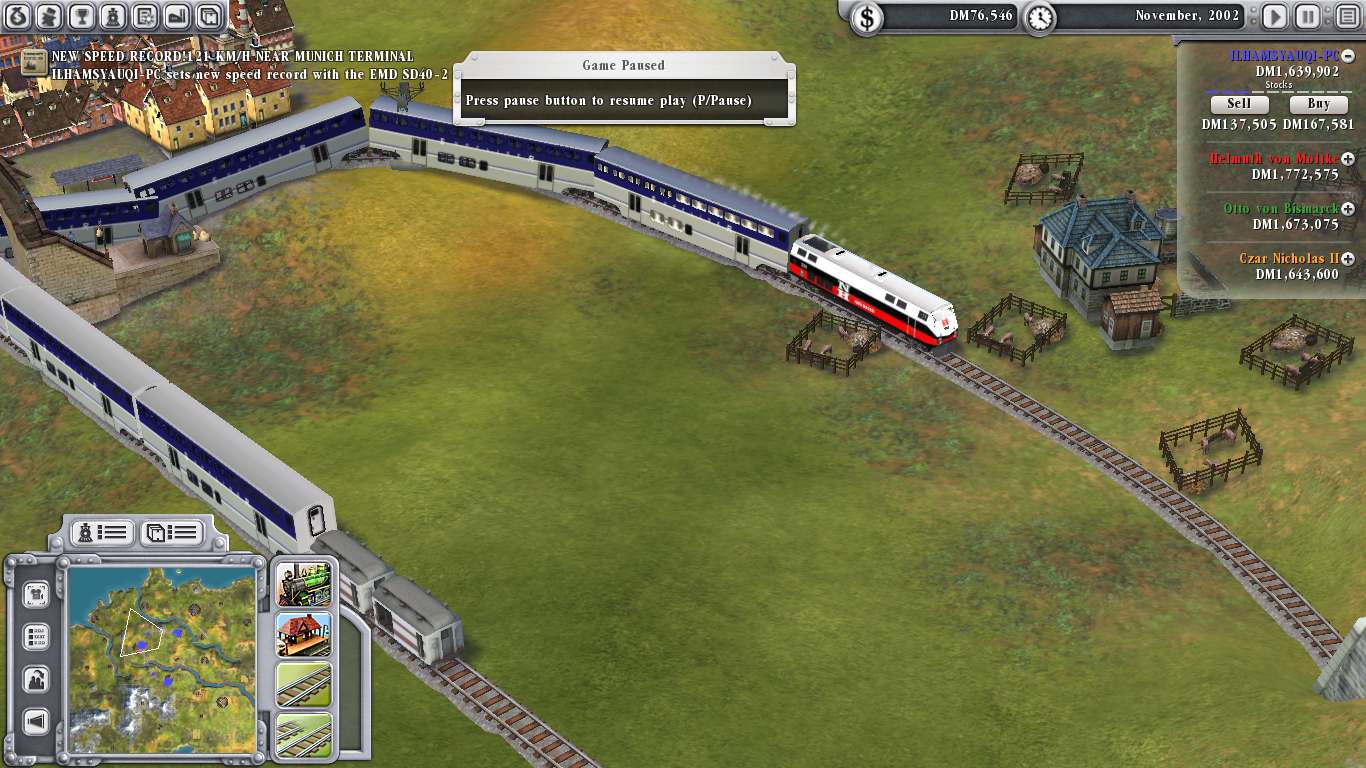

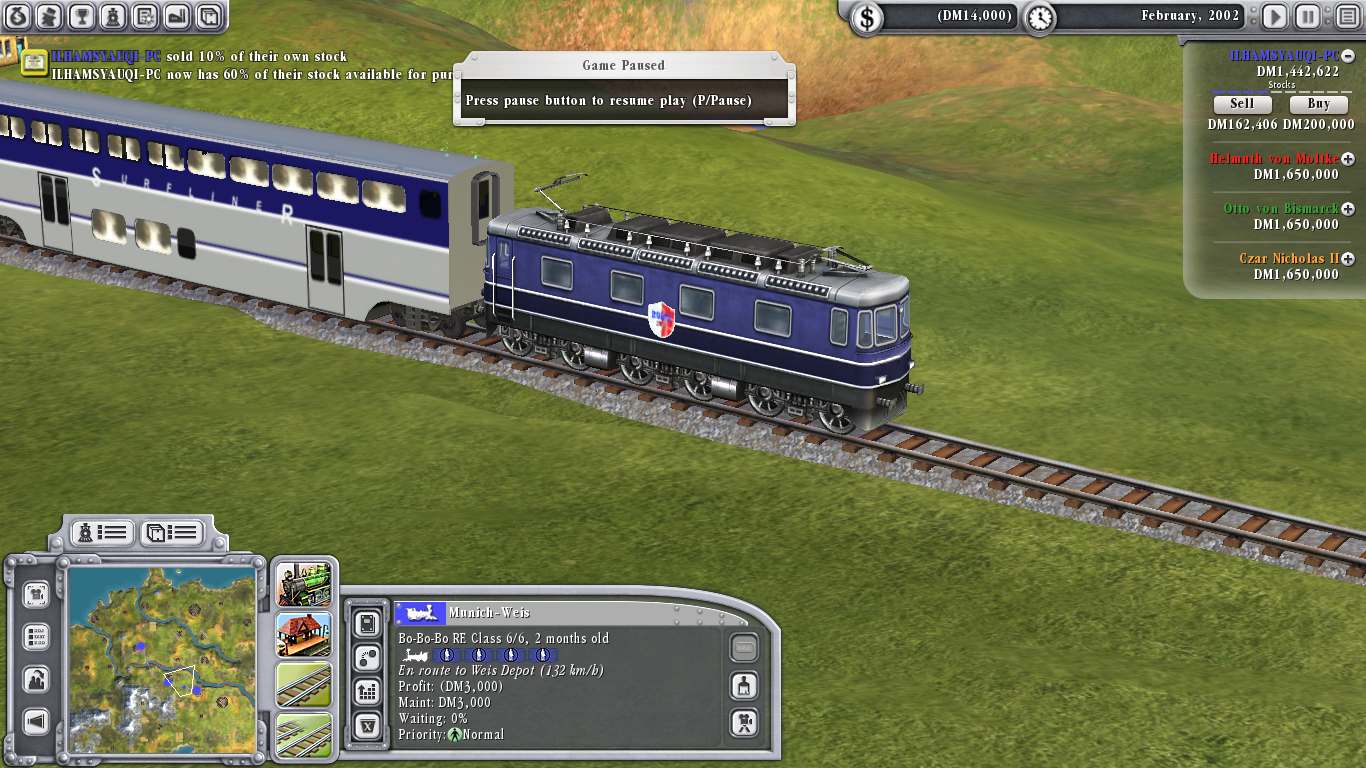

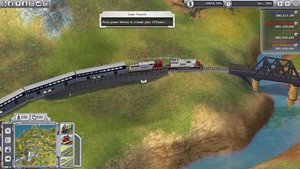

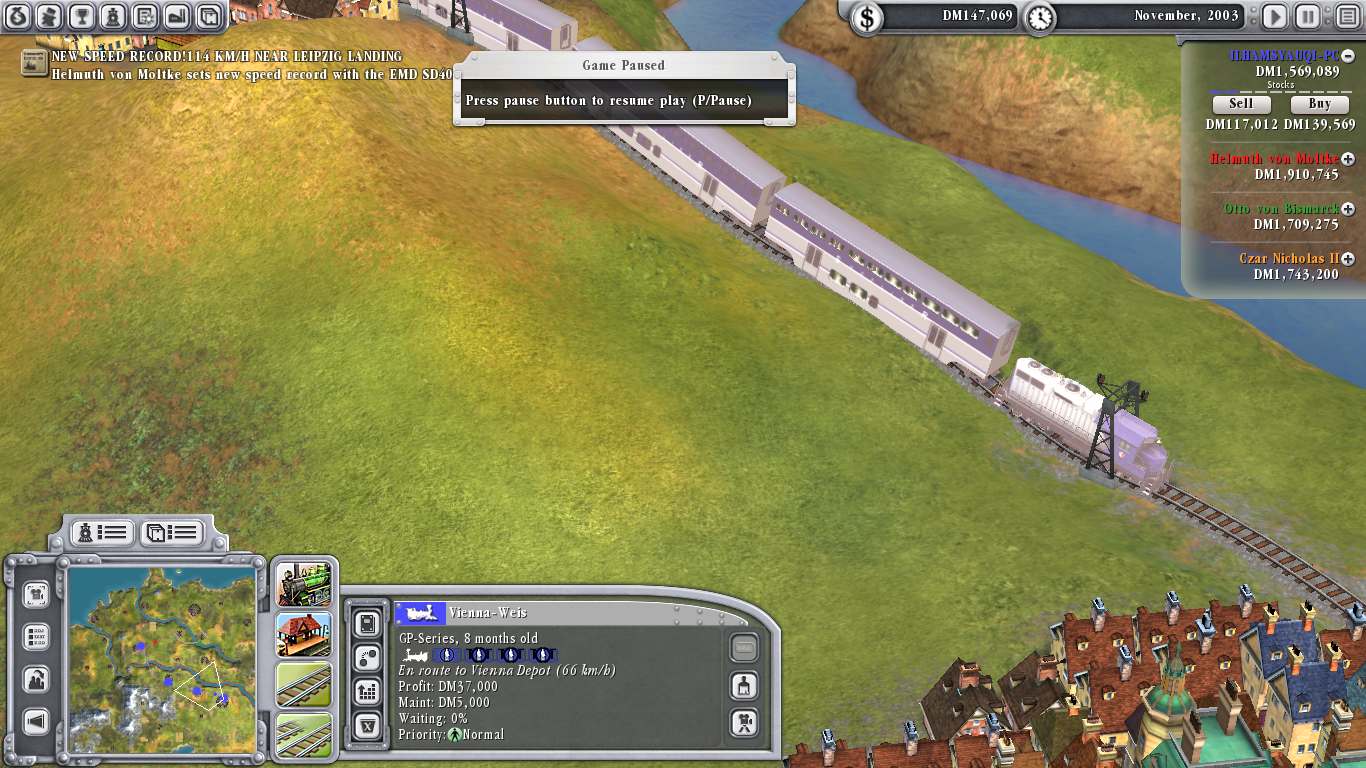

If you want to play with AI, it would require a little trick to get what you want, Open RRT_Scenario_abc.xml then looking for line <TrainsXMLFile>RRT_Trains_abc.xml</TrainsXMLFile> then changing the word with blue color ( RRT_Trains_abc.xml) be RRT_Trains.xml (where "abc" is the name of the map that you play), just it so you can play all the existing trains (original only train), and if you want to play a train that comes as a mod then you must make a new RRT_Trains.xml on CustomAsset Folder by copy paste from the origin RRT_Trains.xml then add listing train that comes as a mod into new RRT_Trains.xml
Note; You not need rename RRT_Trains_abc.xml jut edit the scenario.....
hope it can help you....... :wink:
EDIT//. I just play Germany Revamped Map ( Investor, 3 AIs) with edit the Scenario Germany Revamped with edit line RRT_Trains_Germany.xml to RRT_Trains.xml and make a new RRT_Trains.xml on CustomAssets folder then adding all listings my mod new Train on that new xml file....what happen?...I can run 51 engines ( 39 Ori + 12 mods )
