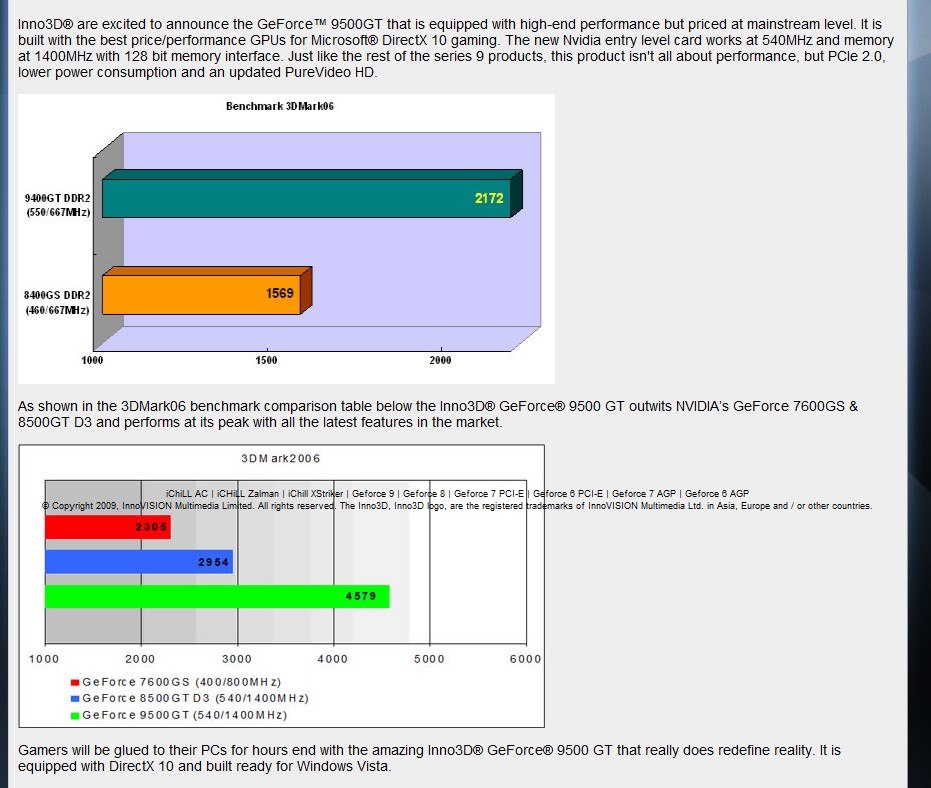

If I were to buy another graphics card, what should I be looking to buy, I'm in the UK and would likely buy it from ebuyer.com. I certainly wouldnt want to be paying much more than £50. However this does seem unnecessary. That site has a:
'Inno3D 9500GT 1GB DDR2 DVI VGA HDMI Out PCI-E Graphics Card'
For £56. Would this make my game play significantly better?
SMR is pretty much the only game I play that is close to modern. I might dust off Footy Manager in the future, other than that everything I play is comfortably over 5 years old.

Would I get a decent boost in performance with a Series 9 1Gb Vid Card? Such as the one I was looking at for £56.
Re: Graphics Issues, High Specs, Low Performance & Watery Hills
Post by karsten » Sun May 23, 2010 4:47 pm
Looks pretty good value for money to me, according to Amazon reviews, where it is a bit cheaper, people run Crysis and F.E.A.R. at high level with it - should be a dream with SMR.
To be safe, maybe you can check with a dealer what they say about SMR performance with this card. 8)
